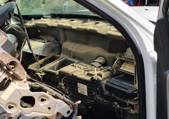

Not only is the smell in the seats, carpet, headliner, glass, vents and the like, it is also in the dust behind the dash and in the air box and vents.
On a hot day it all heats up and emits the smell. I bought a smoker truck with a lot of miles on it. After i got it, I Removed the seats, cleaned the carpets, seats, headliners and windows. Everything I could touch. It got somewhat better.
When I dropped the dash to replace the evaporator a few weeks ago, there was a ton of smoky dust all over the firewall backer that seemed to be another spot that reeked into the truck.
Wiped that down multiple times until it was clean and black not tan, and wiped what I could in the vents. CLeaned the airbox inside and out. It was nasty with all sorts of smoky dust and a/c die and dirt. A/c die has that cow crap smell which added to the smoke smell in a bad way.
Now it's all back together again the smell is much less noticeable. Can't hardly smell it on a hot day.
Ac on high, smells new, not like smoky crap.

@metalchewy That is crazy! I didn't realize how much stuff accumulates back there. Too bad there's no way to clean it easily or I would add it to my regimen lol.
