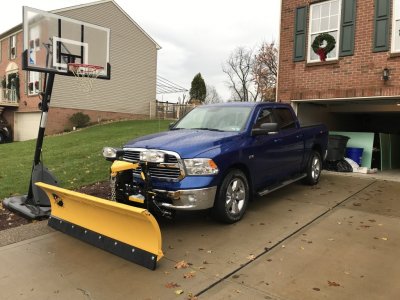

6A7D2906-25C0-4D58-AEBA-5A4123A36000.jpeg i had a snow plow installed on my 2019 Ram Classic yesterday. I plan to only use the plow for my sbusiness lot, mine and my parents driveway. The truck came with 20” wheels and tires. The wheels are factory chrome clad with Goodyear tires. The tires have a very mild tread. I’m sure they are great tires, but don’t have a very aggressive tread pattern. I’d like to keep these for the summer and have a separate set for the winter. I’d like a tire that’s more aggressive with more sidewall for the winter. Any suggestions ? Maybe a 17” factory wheel from an earlier model Ram with a nice set of tires? Thanks in advance, any suggestions are welcomed and appreciated. Thanks!!

If your 2019 classic has the Goodyear SR-A tires get those off your truck ASAP your just looking for an accident. They will slide like crazy on wet roads from slight rain let alone snow covered roads.
I replaced mine with Goodyear Duratracs 275/60R20. They are a common pick for Ram owners.
I personally love mine. I live in northern Ontario with harsh Canadia
winters and I’ve never had a problem

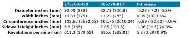

to the op a 17 with a 265/70/17 will be a close match to your 20’s. That’s what I run on mine for the winter on some steelies.
@19Classic if you go with 17" rims, a 285/70/17 is a closer match to the factory 275/60/20 on your truck now.
