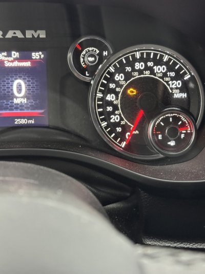

So it begin CEL at 2580 mile.
Mlarv5
Jan 17, 2025
403
903
Crossville TN
Started my truck this morning and was meet by a CEL. Drove my granddaughter to work stopped at the dealer to have it checked. Surprise no stored code just the CEL light on. He asked if I wanted him to clear it I said yup. I checked the Ram App and surprise everything is in the green.
