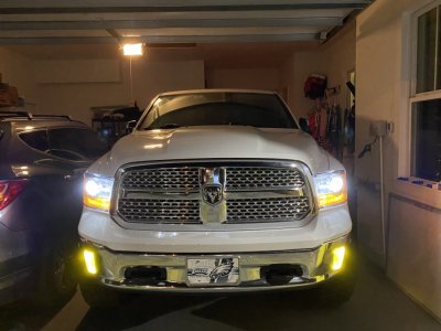

Go to any local shop that does lights n they can help. I have a 17 Laramie 1500 with projectors and grabbed some 9005 LED bulbs. Came out great. I went in for HIDs, they talked me out of it and glad they did. Much cheaper and not worried about all the extra mods during install. Now if you have reflectors HIDs are way too bright and LEDs are the way to go. Should also be 9005 but you can find out online or by pulling the headlight which isn’ta big deal. PS also grabbed the yellow LED dogs on amazon. LED lowbeam = $90 ; LED fogs $20
