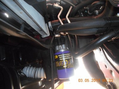

66gwc reported no noticeable psi either way with that set up, good upgrade for these hemi's imo. Not a bypass, just a double filter.
I gained about 1 or 2 psi at hot idling temps Mike. Truck hot idles at 51/52 psi operating pressure depending on engine rpm is between 55 to 57 psi with 5W-30 Redline. The biggest change was the oil temps,they're a good 10 degrees lower then they were with the stock filter set-up,and a good 5 degrees lower then they were with the old single remote set-up.The trucks had a couple oil filter set-ups,but the dual remote set-up seems to be the best set-up i've had on it so far.

I took care of the insufficient filter media surface area problem,lol.
Also ran this same set-up close to 40 years ago on my old 68Z when i was a kid:waytogo:

The dual filters brought my hot pressures up a few psi,less pressure drop across the pair of them then you'd have across a single filter.They're also the big old style PH8 filters,common to the early Fords and Mopars way back when
