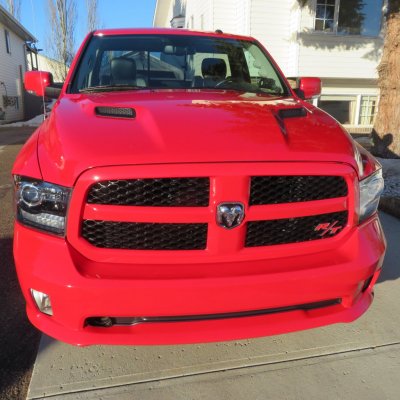

It started out as one of Transdapts 1227 kits ,that i upgraded the hoses and fitting to -10 (5/8").It uses the older 3/4 X 16 filters (ie: old Mopar / Ford PH8A style filters) which you can get anywhere,i use Royal Purple 30-8A filters on it.The hose is dryer ducting feeding my air box,in the pic with the dual filters i'd got around to wrapping it with black tape so it doesn't stick out as much,at the moment it's routed out to the front bumper on my Sport,but i did pick up a new piece to replace the piece of plastic it's routed through,and one of these days i'll probably re-route it up to the grill area instead.You can just barely see the inlet on the pass side of the lower black valence in this photo

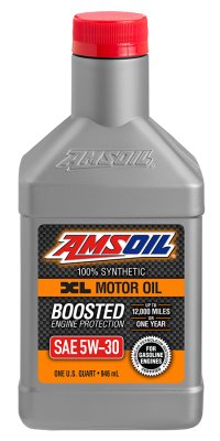

I have been using AMSOIL in every motor (truck, car, motorcycle, lawnmower, weed whipper) since 1984 and have experienced ZERO problems. My performance/MPG goes up when I get rid of the OEM oil.
I have been changing my own oils since the early 70's and I have used probably every oil known to man and I have experienced ZERO problems in any rig. Believe it or not I had a Honda rider that was well over 20 years old and I mow over an acre couple times a week and never had an issue. I used all the left over partial qts of oil at the end of the year in it. figure a little 50 weight from the harly, 0-20 from the CRV, 10-30 from the subaru, and whatever else I had. never mattered the thing just kept on running. Maybe the mpg went up when you got rid of the OEM oil was because it was starting to get broken in.
