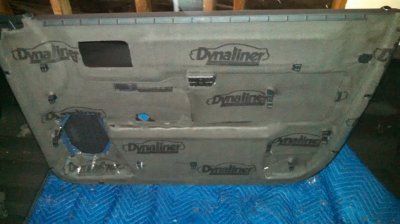

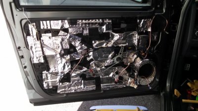

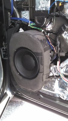

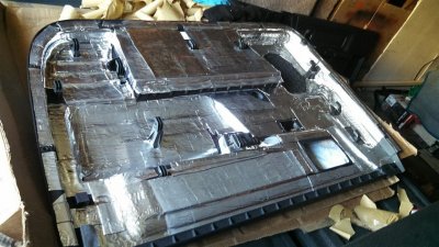

Here is what I did on mine...

I think DavidRam covered everything to deaden, nice work!!!. After I deadened my doors the one issue I had with rattling was the black glass guard at the top of the doors when you remove the panel. added a strip of roadkill under it...no rattles now

DavidRam did about as good of a job that can be done. When I did mine, (david will agree) I did as much of the black plastic inner door card as possible, then the INSIDE on the outer door card (door panel itself) I did not have the time to remove black plastic inner door card, so I opened up the rubber access panel on the black plastic card, and placed (i have long arms which helped) TWO 8x11" panels of butyl rubber deadener up inside the door attaching them to the inside metal skin of the door itself. Not a lot of room to work, but it can be done. Then I reached and roll-pressed the deadener as best as possible to the metal skin. This step along helped ALOT with panel vibration. Get as much as you can up there on the skin, one or two big slabs will help a lot....best of luck and take your time. Now if you want to go even further, you can start adding CCF, and MLV between door panel and inside door card. That's when your truck starts to become as quiet as a vault

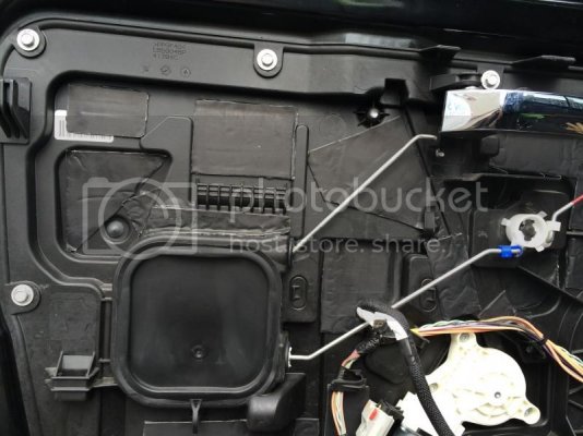

I went all out on mine as well using Second Skin products. I did the inside of the door card but I apparently don't have any pics of that but since I cut my door panel apart I had a lot less structural to stop it from moving so It got a full coating of CLD tiles.

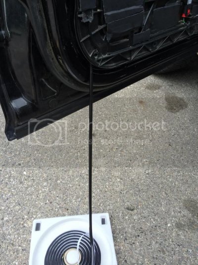

I left the plastic inner door panel in place because I didn't feel like pulling the window and riser out with it but I did run a bead of Butyl rope around the perimeter before tightening it back down.
After that every flat surface, and some not so flat on the inner door panel got the CDL tile treatment. You only need to deaden the panels that are unsupported which for the door panel is just every vertical panel.
I did the same thing as auto and reached through that plastic panel and through the speaker enclosuer (that I cut off) to get a bunch of CDL tile on the inside of the outter door skin. On top of that I also put a self-adhesive layer of a CCF/MLV combo.
