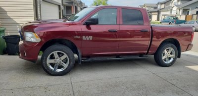

just the Bilsteins for me. leveled out perfectly. if i wanted to add a rake i would have got rear spacers as well. but i like it level. i don't tow, only heavyish loads i have is going to the dump occasionally. i probably keep 50 lb of stuff in the back on an ongoing basis.

yes. 2.1 inches on mine gave me 39.5 i think it is, front and back.
