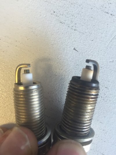

So it's 57.8k on the dot. So doing oil change and plugs... What are the gap on the plugs? I bought the plugs at the dealer ship...
These plugs were either done at 30k or original, can't tell... But here the difference... f2d388375eb61f891dc6fb2027c83378.jpg
Doesn't look warn at all... Should I do all 8 or just put them back in and return the plugs...

From my understanding the 4.7, 2008+ should have 16 like the hemi 8 on top 8 and on the side. The top plugs are recommended every 30k and are copper and the side plugs are 100k platinum. Hope this helps.
Also those plugs do look in good shape how long have you had the truck?
Edit: upper bank .040 lower bank .051 on the gap.

Thanks, well I bought the truck at 43 and pulled one and it looked like the one in the pic, not sure if they were done at 30 or not so just doing them.. Just wanted to make sure. The old plugs don't look that bad...

Which location did you pull that one from could it be a lower one thats rated for 100k? And it's possible that someone didn't do them until like 35 40k giving you some more time. Its easy and cheep wouldn't fault you for doing them just because. I did mine just because the previous owner was a little laxed on his maintance.
Edit: also thinking about it the dealership may have done a tune up before they put it on there lot and that include plugs.

Everything was bad when I bought it... It was the top... Haven't touched the bottoms...

It's probably worth doing just not to have to worry, I wouldn't touch the bottom ones unless you really want to the 2013 owners manual was upper 30k and lower 100k so personally I wouldn't worry about those just swap the top 8 and call it good.

58k pretty much, the pics of new and old are in the first image of the post.. They must have been done at 30, or this engine runs über efficient! The two owners prior to me was enterprise car rental, and a woman who supposedly owned it for a few months and then traded it in for a vw! The truck was a certified pre owned but I bought it at a VW dealership. I'm sure it's just siezed in and that's it! I just want to think what my options are. Let's say it's seized and they pull it out and pull the threads out, are they going to put it on me? If they pull it out and for what ever reason the threads are crossed and they were done at 30, are they going to say, sorry we didn't do the last plugs, not our fault, your bill? That's all. Truck is running fine and never has had a miss fire code so I'm going to play the ignorant card, if something happens
All other plugs went in no problem, hand tight then 1/8-1/4 turn with wrench and done

So the pugs have never been changed. Rental companies don't maintain the vehicle's other than wash and vacuum, the woman probably didn't do it either. Your plugs look right for the mileage, I went 156K on my stock plugs and they weren't much worse. Don't worry about it, they'll change it and all will be good.
