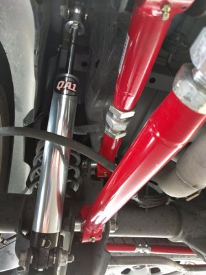

2/4 drop on my 15' RCSB with spohn panhard, UCA,LCA ,QA1 front and rear adjustable shocks , hellwig rear sway and shorter front sway bar end links. Completely different ride. Love it!
What PN are the QA1?

FYI both sets of my Spohn arms after 2000km needed to be removed, and the del-sphere bushings needed to be tightened. Truck was clunking over bumps in the rear

pics of the truck?
Are those the Moog front end links? If so be careful with them, they are way to weak for the Hellwig... I had a pair for a couple months and they started making noise and when I finally pulled them off they were bent.
David which front sway bar end links did you go with the Hellwig?
I got the moog f150 end links, now you got me worried
