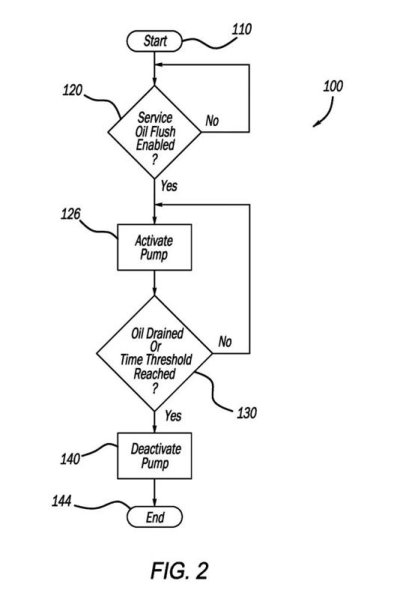

In practice, the maintenance procedure begins with a technician initiating the oil drain or flush service via a service computer. After removing the drain plug, the auxiliary oil pump is activated by the transmission control module.
The pump then circulates the existing transmission fluid, effectively expelling it through the opened drain hole. This active pumping mechanism ensures that residual fluid and potential contaminants are thoroughly removed from the system.
New Stellantis Patent. Image: United States Patent and Trademark Office (USPTO).
To determine the completion of the drainage process, the system employs multiple evaluation methods. These include monitoring hydraulic solenoids for fluid flow changes, tracking the pump's runtime against predefined thresholds, measuring the volume of drained fluid, observing variations in pump load, and technician verification of minimal fluid discharge. Such comprehensive monitoring ensures that the fluid replacement is both complete and efficient.

If removing the drain plug does not allow the fluid to drain without using a service computer, then, this negates DIY fluid changes, mandating service at a dealership.
Maybe that is the plan all along for the automated drain.
