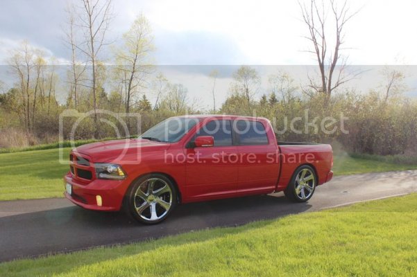

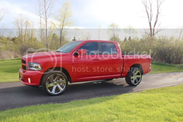

So far from one install, axle brackets came off in pieces. So it likely wont be easy to go back to stock with the cut brackets IF thats an issue for you. I plan on using the NONE cut bracekts with my air system. It'll give me better angles and axle postion, maybe not bang on perfect, but better then it is currently.
My Truck with no air in system
Fulll air
Has ART kit

All depends on your overall plan. For me, to cut the mount off, then have to revert it bakc to stock in a year or so when I trade it in makes no sense.
