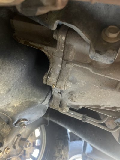

Hey J, any luck getting this resolved? I’m having what appears to be the same issue in my 2014 Hemi.

That's exactly what mine looked like! ...and no. It stopped puddling on the ground and ive had other things more pressing. Coolant levels seem fine so I put this on the back burner

Interesting. My coolant levels are fine too but still waking up to a small puddle every morning. I’ll report back when I get to the bottom of it.
