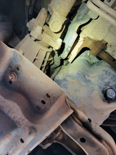

Got the chance to get under the truck this morning an took a couple pics. All this is fresh. Last night I sprayed it all down with brake clean, cleaned off the dirt, grime an old fluid. All that appears to be new leakage.
Any ideas where to start? @crash68
The circle on the picture are where the coolant lines attach to the TMUScreenshot_20230125_160724.jpg
Although your leak looks like it maybe on the back of the engine. Not sure if the Hemi has coolant passages on the intake that could leak, as it maybe coming from the top of the motor

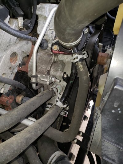

Also... this project just took a turn. Followed @crash68 advice and looked higher on the block. There does indeed seem to be something leaking from the backside.
I don't have any symptoms of a cracked block/head gasket yet (no overheating, oil in the coolant or coolant in the oil, pronounced white smoke, etc).
Will most likely rent a block tester from the auto parts store asap.
Is it possibe for a head gasket to blow out the back like that and only leak coolant externally?

@Daniel Ortiz Yeah, Im 99.9 percent sure its coolant...at least when it gets down to the area that I showed in the pictures (between the oil pan and transmission pan). The coolant I have in my truck is orange (Penzone I believe...) and the fluid that drips (again, a fairly slow drip. Came out this morning and everything was dry again) is distinctly orange. Doesnt seem to be discolored by oil in any way.

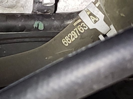

@indept that reminded me, I've been wanting to replace the coolant hoses attached to my thermostat housing since I replaced it last month. I noticed my housing had a small 90-degree offshoot from the main housing, and saw 6829763(7)AA on it.
Turns out that Mopar part is the coolant transfer lines (rubber hose ends and metal pipe runs in between) that deliver and returns coolant to the TMU.
@Jwrigh12 I know it's only for 2017-2022 5.7L Rams, but I wonder if your 2014 has something similar. If so, could one of those end hoses (the ones on the transmission end) be leaking for some reason? If your 2014 is set up similarly, two of those rubber hoses join the metal pipes right over your transmission. You can see the pictures of the whole setup at the Mopar part link.
