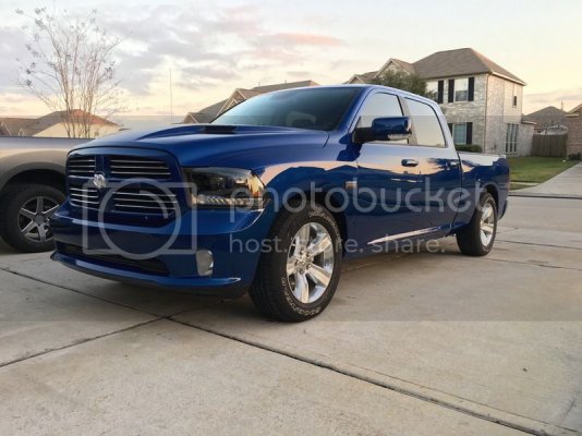

Pulled my 17s off and went back to sports. Also installed 1.75" B.O.R.A spacers. Love the stance with the 2" drop
Looks great bro!
Is that just 2" drop springs in the rear?

I forgot to post in here the other day. Last week I installed the Ground Force 2/3 kit on my new 2015 crew cab 4wd. This is how the truck sits right now, but I will throw some new pics up Wednesday or Thursday with my new wheels and painted headlights...
CMil527
Dec 8, 2014
3,140
565
Old Bridge, NJ
2021 RAM 1500 LARAMIE-CC
looks great... which wheels u going with?
