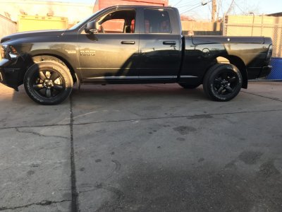

I was on belltech's website and didn't find a full kit for the 4x4s

from you picture it looks like you have a regular cab Belltech does not list a drop kit for the regular cab just the quad and crew cab 4x4's. The part number for those is 965SP I am sure you could adapt this kit to work with your standard cab truck just certain parts would not be used.
