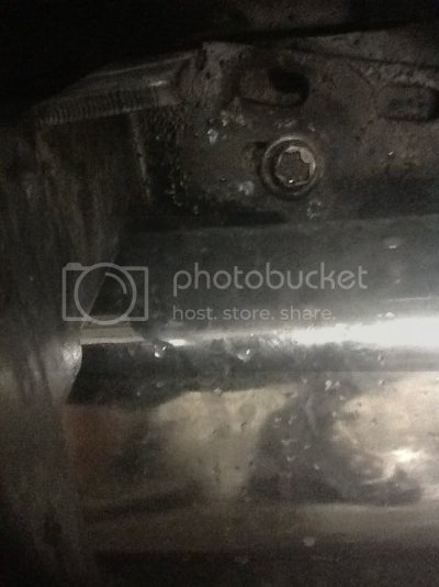

Ok so I've got an issue,one of the bolts that bolts in my tow hook and brackets for the bull bar will not budge, it's getting to the point where I'm afraid ima strip it so do you guys have any suggestion, sprayed a ton of pb blaster, wd-40 and penetrating oil and nothing, then heated it up with the torch and nothing....help!!!!!

Ok so having no luck and me not being patient I almost lit me truck on fire and have almost stripped to bolt-_-

Got any pictures of the bolt? Odd that its stuck like that. May have to end up cutting it off and getting a new one.

Used a 12 point as that will all that will work, with a breaker bar and cheater pipe and all it does now is jump off the thread... Heated it up several times doing this and nothing.... Like all the other ones were a joke coming off except this one.... Can't even get it to budge with a wrench

Well I have tried both bud.... It's not that fact that it won't budget anymore, now I cant get a socket to stay on, it's a 15mm socket, looked it up on last instruction sheet to double check and the damn thing is being stubborn, I though about taking off the bumper to get a wrench on it but I'd rather cut it off.... But if I cut it off where???? There is almost nothing of the bolt showing

Ive had a problem with a screw I couldnt get to before. Ended up drilling it out through the top of the bolt.
