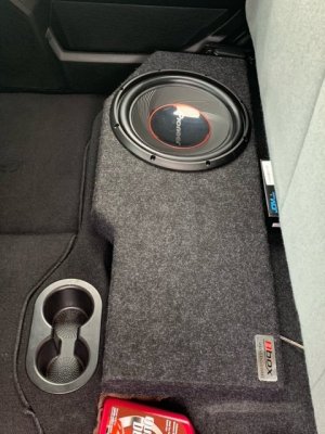

So I have a Pioneer DMH-1500NEX headunit. Boss R1100 AMP and a single under the seat mount box with a 12 Pioneer A-Series sub. Im not getting the bump i thought I would. In my other car I had same amp with a RF Power DVC sub, and it hit so hard. Could it be that the speaker doesn't have enough air in the box? would I be better off going with a dual 10" box instead of the single 12"? Or can someone help with the setting for the amp/radio to get the best bump. Thanks in advance.

The amp is the only thing on the power wire, with a 40amp i think fuse. and it is the only thing on the ground wire.
this is the sub box
  • Dimensions Sub cut out: 11.125”, mounting depth:6”, height: 7.25”, width: 32.7”, depth: 13.25”
Speaker is
  • Model # TS-A30S4
  • 1,400 watts max
  • 400 watts nominal
Im thinking of returning the box,amp,speaker and just getting a dual 10" system. Think that would be best?

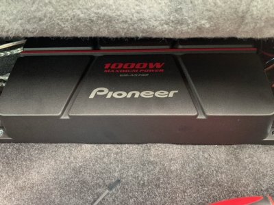

So I changed some things and have some question on how to wire the sub to the amp.
The amp I’m using Pioneer GM-A5702
Subwoofer DS18 GENX124D
So with it being a DVC I have positive to negative on both voice-coils. Then the speaker bridged to the amp.
Is that the correct way to set it up? Reason I’m asking is cause some times I’m getting the amp speaker/amp cutting off to a second. Then I turn down the volume and it comes back on. So just wanna make sure I have it wired up correct before swapping out my RCA wires.
For a single speaker with dual 4ohm coils you want to run positive to positive then to amp and negative to negative then to amp. This will give you a bridged load of 2 ohms (make sure your amp is 2ohm stable). Check out this site, I remember using this when I was a teenager playing with boxes and subs.
Sub ohm calculator
If your amp is cutting off then coming back when you lower the volume, you might have a voltage issue. What gauge wiring are you running, where are you pulling power from and where is your ground running to? Can you post some more pictures?

That is how I have it wired up. I’m running 8 gauge wire direct to the battery. And grounded at the mounting bolt for the rear seat. Again with 8 gauge wire.

Crank system up, meanwhile check voltage AT the amp....see how low it drops.

So I haven't been able to get my voltmeter out yet of my storage area. but i did notice that when the volume is up the dash lights flicker and so do my led headlights. So I'm sure it is a voltage issue. Should I capacitor cap help? and what size should I get.
