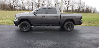

Hey guys! My ram is currently running 35x12.5 with a 2.1 bilstein level on the front. My build sheet also shows a stock 1 inch lift ( no idea why).
Anyways I'm looking for a 4" lift
I'm on a budget but would also like to take in my options! Feel free to educate me! I dont need the best but I definitely don't want the worse.
She's a road queen but I do enjoy going off road if I find a spot.
Regardless hope everyone is healthy!

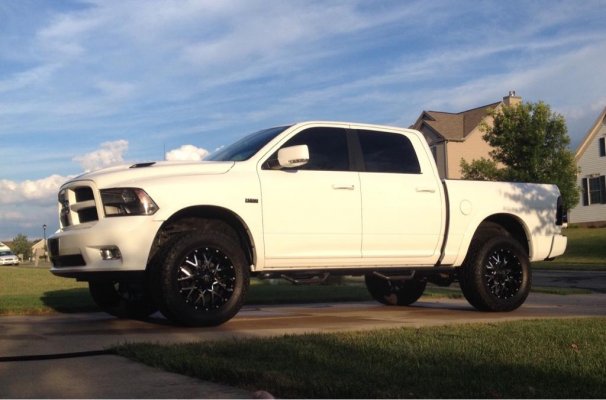

Zone 4”F/3”R w/bils at 1.4” .... Rides/handles great .... Won’t break the bank .... Slides in 7’ garage door w/35’s .... And perfectly fine for the occasional offroad trip81f4f44e66240004d0b92db2af331223.jpg

That is the look im going for thanks for the response everyone!
