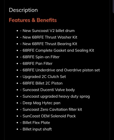

I'm leaning towards the Suncoast 68RFE Category 3. There's a dealer / shop a couple hours away and they can do it in a day. Which includes doing the learning process. I also wouldn't have to pay up front the 2k core charge by having them install. fe7abd94e6c38752391af66d9685541e.jpg
