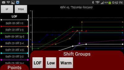

So I'm finally getting around to starting to mess with my trans tuning. I have downloaded some files from here that I am going to try. The tuning on the vivid seems different then what I see in the spread sheets that I downloaded. Has anyone used the vivid for tuning that can point me in the right direction?

I'm thinking the torque map should be the same in 2nd as all the rest on WOT what about pt? And what is the difference between LOL low and Warm? I'm guessing warm is engine temp at normal but not totally sure.

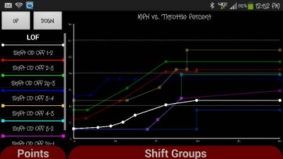

So I took a stab at it this morning and it wanted to auto fill some of the mph settings when I would try to change them.

using the vivid I found it easier to just slide my shiftpoints up/down on screen instead of trying to input them via number pad, for some reason it wont let you input the #'s you want and will autofill the # for you..
