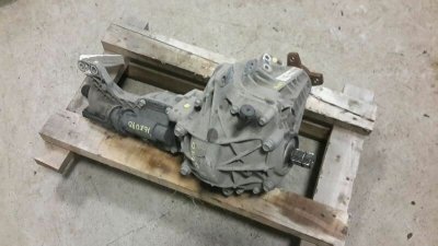

While I'm rebuilding that rear axle I would love to also install a set of 4.56 gears to get back some acceleration and ease some of the wear and tear on the old transmission. Or should I consider 4.92s? Of course, this brings up the issue with the 2011+ Ram 1500's and their unswappable front diff gears which are welded in.
So here are my questions. What is the smartest way to swap gearing?
Option A. Buy a cheap/used $250 2009 Front Diff and rebuild it with 4.56 gears? Is a 2009 front diff assembly a true swap out for a 2012? Would I need to get the 2009 front driveshaft? Would I need to build an adapter to mount the diff assembly? Would I need a new pair of 2009 CV axles and would they fit through my 2012 wheel hubs okay?
Option B. Stick with the 2012 Front Diff but swap in a 2009 diff case with 4.56 gears? This seems like a no brainer if a different carrier would fit, one that I could bolt a 4.56 ring gear to.
Option C. Don't bother swapping out the 3.55 Factory gears.

If I remember correctly from my swap, the CV axles from the 2009 are needed, and the driveshaft needs to be replaced as well. For context, I switched from 3.55 to 4.10s in my 2012.

Very interested I picked up front rears with 392 but am going to a 37” tire and would love 456 so this could change my whole approach.

Is rebel front diff equipped with a limited slip? Or not welded ? Or stronger ? Deeper gears ? I’m just curious if the specific advantages as opposed to fronts of other 1500 thanks.
