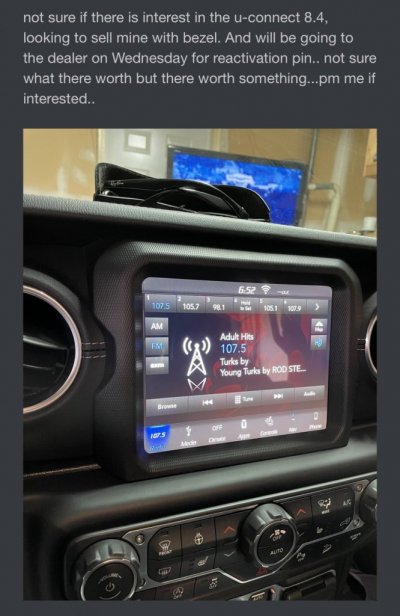

This is the unit i want to swap out of a 2019 JL Sahara and install in my 4th gen (2018 Ram 1500 Express 5.7)

The mounts are different and would have to be changed.also it's iffy if the firmware application version will work like it should. The Panasonic radios aren't as forgiving as the almost universal ra4/ra3 harmon radios are going from vehicle to vehicle.
