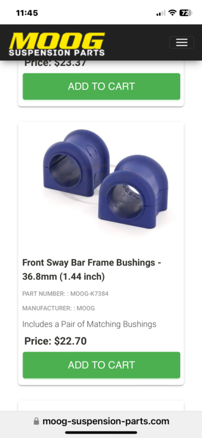

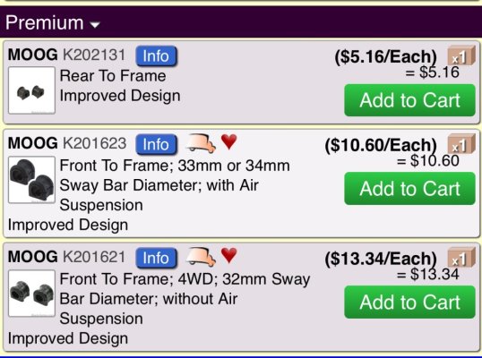

I was looking at the sway bar bushings on Rockauto. I put some Dial calipers on my front swaybar to check the diameter. It’s coming out at just over 36.5 mm or 1.437 inches. Apparently, at rock auto they are saying this size Moog bushing is for “air suspension” models. Can anyone explain this? I’m using a set of Mitutoyo dial calipers. The sway bar diameter is 36.5mm. I want to buy the correct bushings.
Apparently, rock auto is not showing the correct part number. I went to the Moog website and found this bushing.

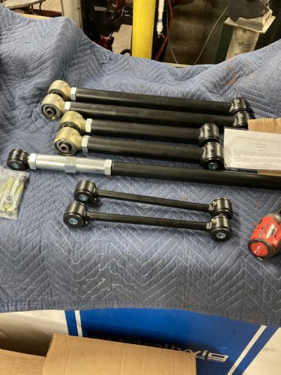

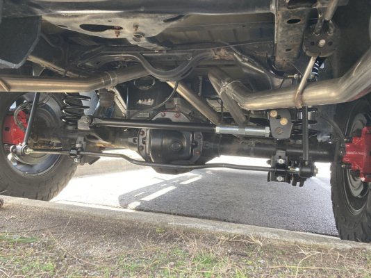

Did you check All Mopar Parts on this forum? I have the hellwig rear sway bar, definitely an improvement over stock & adjustable, I was surprised how light the stock one was.
I have the Core upper & lower control arms, again to me an improvement over stock, truck feels “ more planted” especially on curves with bumps like highway exits.
I recently replaced front sway bar, mine was rusting mainly in the curves near the end links, there is no aftermarket for the front but the stock is very solid.
I did the front bar myself but all other suspenion work was done at Quick-Shifters shop, ak_trucks_pa the only shop I trust with my truck.
He uses a manual torque wrench for all final installs & close enough or should be ok isn’t in his vocabulary.
Make sure truck is on the ground before final torques.
I have no regrets/complaints with any of my currrent setup
