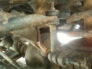

heres the pics of the links. The second pic is the drivers side, and the rest are the passenger side. Thanks again.

Those look like factory sway links to me. I'll post up a pic and some measurements of mine off a '97 so you can compare the two

Here's mine 1st one is passenger side and the other is the drivers

Thanks for takin those pics. How come mine didnt come up as big as yours were?
The measurement is about 6 1/2" to 7" from the top of the link to the bottom. I couldnt really get a more exact measurement bc the ground was all mud and I couldnt really get under there too good lol

lol they look like theyve seen better days.. Your links do look the same as mine, so I think I'll be able to buy the stock ones for it. Thanks so much for takin those pics for me, that helped alot.
