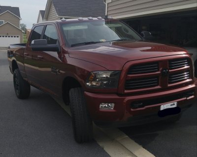

Well after the last towing trip with 6.8-7 mpg results i couldn't take it and started scouring the internet for a diesel. Well i found one. I'll miss the quick on demand unloaded power of the 6.4 in daily driving, but certainly not the frequent gas station trips or crap mileage. Found a '17 CTD 3500 BigHorn Crew with Sport Appearance Pkg and got a good trade value and great deal. Still on my first tank of fuel averaging 19 mpg after 165 miles and still over 3/4 of a tank left. Luv'in the turbo spool and jake brake. The pictures aren't the best, but still think it looks good.
