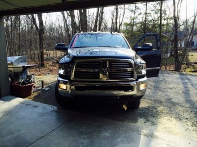

New switchbacks are in. Next up is the clearance lamps.

Changes the turn signal bulbs. When your parking lights are on they show white. When you put ur turn signal on the flash yellow.

Which ones did you use? I had issues with the ones from superbrightled.com.
I got them from retroshop along with a harness he makes so I didn't have to cut the stock wires. I also had a problem but talking to jj he said I was going to need two resistors per side. So he sent me another set and I hooked it up. Everything works fine now with no bulb out msg or hyperflash
