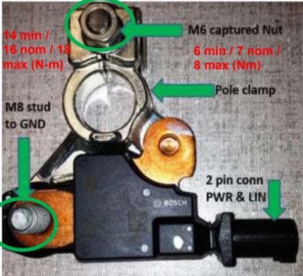

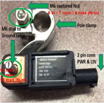

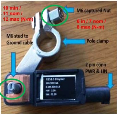

As Dean mentioned, open the hood and look at the negative battery post, you will know instantly.
The weather is too foul for me to walk out to the barn to snap a pic. Instead, sitting by the wood stove, I found examples on my PC.
AFAIK, they have been using the IBS sensors for many years on all models of Ram trucks.
The IBS on my 4th gen truck is one of the last 2 pics. I know tb56 has an IBS on his plain Jane 2019 5th gen too. We both have a Hemi with no E-Torque or as Mike always says, no E-Junk here. :cool:

Good of you to look up pictures but the pdfs I posted have the same pictures. That was why I was a bit annoyed that he didn't at least go look at his own setup.
RamDiver
Jan 23, 2022
5,720
12,075
Marlborough, Ontario Canada
2021 DS
Yes, I figured as much.
I wanted to expose the pictures for those who are using a phone and ignore attachments or are just too lazy.
Then they have even less of an excuse. :cool:
