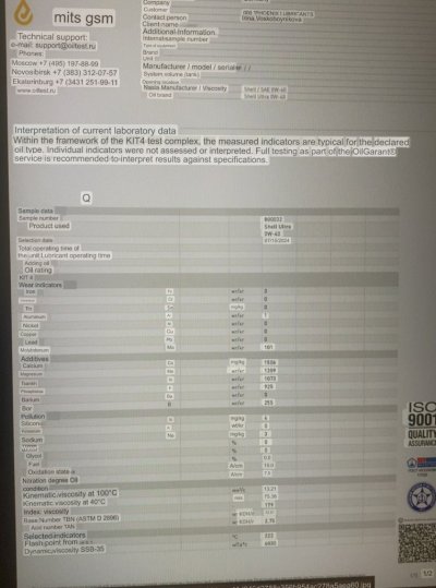

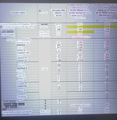

Since we outside the U.S.A. have access to different products, I thought that it would be good to research and provide as much info on them.
That way those who don't have access to Redline, will have options.
This is the VOA for Shell Helix Ultra 0w40
Shell Helix Ultra 0W40 UOA
Since nothing was available on BITOG, I went to the Russians.

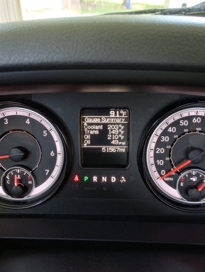

My 2017 HEMI 5.7 at "hot idle" after an 30 mile "round trip" errand run.
•Red Line 5w/30 and Purolator Boss PBL 24651 oil filter•
