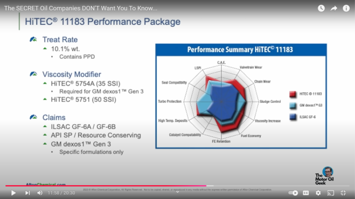

Here's his presentation chart that really gets me, how much weaker ISLAC GF-6 additive is than GM Dexos 1 Gen 3. The big miss is oxidation stability - ESPECIALLY important for turbocharged engines!
But - like he says, lack of certification doesn't mean they don't meet it - it just says they won't pay for the license. Most infamous of all is Amsoil, who shows test results far exceeding most specs. I just don't know about PUP - Shell is European Corporation HQ in Holland. Do they really no longer care about the U.S. lube market?

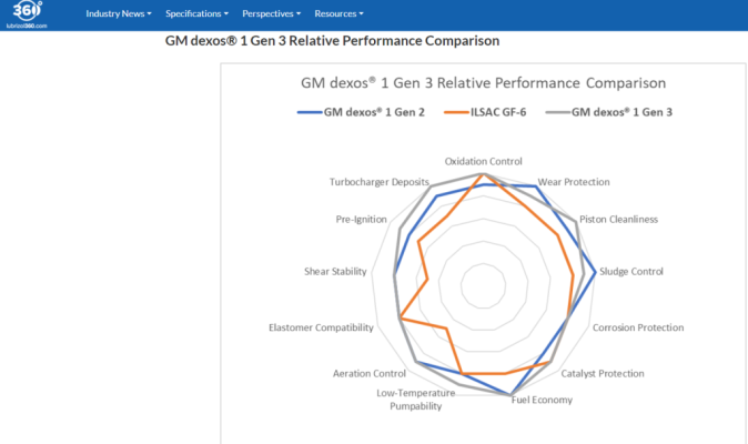

GM Dexos 1 Gen 2 vs. GM Dexos 1 Gen 3 - Costco lists Gen 2, no Gen 3. Gen 3 just looks like a additive recipe tweak, to me. It allows a little more wear but reduces high temp deposits. From one of the four big additive packagers, Lubrizol:

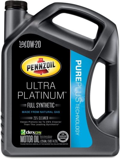

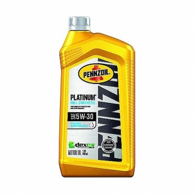

GM Dexos 1 Gen 3 Certified List - Pennzoil Platinum listed, Pennzoil Ultra Platinum isn't. wtf?
good find, so I hadn't seen the donut on the bottle, hopefully we can find one, this is one donut you do want imo. I stand corrected. Brian I think Pennzoil doesn't sell enough PUP to pay for the donut, most places straight stop selling pup.

OR, maybe they consider PUP as part of platinum line, yeah that's it, lol Burla needs to go hide under a rock now.
But dexos still means that high standard. Perhaps they will update at one point, but especially for older engines dexos 2 is gonna be great oil imo. For the rav 4 or even a hemi this will do, if we are grading that oil against the field of group 3's. How old is dex 3 anyhow?

Yeah, I was poking around and found min. wear HTHS for Dexos 1 Gen 2 is 3.5 mPa, Dexos 1 Gen 3 is 2.9 mPa
So they put in a bunch more detergent in Gen 3 for the dirty, single injector GDI engines for higher wear. I guess I'd agree with that, seeing as how sooty the single injector GDI engines are. If I had a GM HD truck I'd be conflicted with a GDI 6.6L V8 engine towing heavy loads.
But since we're driving go karts, I'm thinking of switching. I have no idea what Shell is doing. And they aren't saying anything that I can see. At any rate, since we're changing these kinds of motors @ 5k OCI anyway, looks to me like Kirkland is a good way to go?
Another sea change in engine oil thanks to never-ending EPA fiddling. I thought utopia back in 2014 was PUP.
