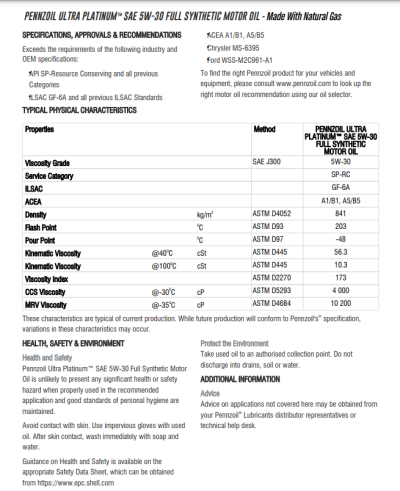

PUP is what we thought it was (apologies to the late, wacky coach Dennis Green):
Here is Lake Speed again from a year ago with differences between Pennzoil Platinum and Ultra Platinum.
Takeaways -
- Both are same visosity in 5W-30, but are a very light 30 weight (only 10 cSt @ 100C)
- PP is Dexos licensed, PUP is not
- PUP has MORE antioxidant, detergent, and antiwear than PP
- PUP is BETTER than PP, despite not being Dexos licensed, in terms of not degrading as fast (oxidation), cleaning engines (detergency), and wear prevention - just as advertised and as we thought in the last decade.
- PUP can be used in Hemi, but needs more moly than stock (has only 97 ppm Moly), which is why guys add LubeGard Moly supplment
- PUP is marginal for heavy towing due to the light 30 weight viscosity. I stick with Red Line 5W-30 for Hemi.
- PUP looks like a great oil for small 4 cylinder engines with single injector GDI and turbos.
- PUP is BETTER than a basic Dexos oil.
Is Shell planning to Dexos license? Who knows? Maybe they just push PP because most buyers are price sensitive, so no point licensing their super oil?
Bottom line - PUP is preferred to PP (per me). Other Dexos oils might be as good, or not, unless somebody does a VOA.

see my post on previous page, PUP has dexos on the label.

When did that happen? Spec sheet doesn't/didn't?

Weird, PUP specs old GM specs but not dexos on their page, and is on some bottles, weird?
Is GM6094M the same as Dexos?
dexos1™ is factory fill and service fill in all GM gasoline engine vehicles. dexos1™ supersedes the GM6094M, GM4718M and GM-LL-A-025 specifications for 2010 and older GM vehicles and is now the only motor oil GM recommends for those vehicles. GM's brand of dexos1™ is a synthetic blend, not a full synthetic.
If it doesn't say dexos, then it isn't dexos, unless it is super recent.
