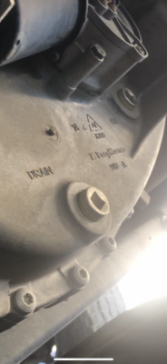

Alright so I’ve changed my rear diff fluid out and swapped my engine oil out for redline 5w30 from redline 5w20 and when I went to change the transfer case fluid I thought I had the correct bit but I don’t and I can’t figure out what is needed. Can anyone tell me what the correct bit is to change the transfer case fluid? It would be greatly appreciated

I did not try the socket extension. I’ll give that go tonight and see. Yessir I don’t want to make that mistake. No rush I plan on doing it Wednesday but if I need to order the part I want to give myself time.

I think I did need to get an off size but I can't find it. See if socket extension work, if not you will have to go get it. If I remember, I had to go to hardware store and try 3 sizes before I found the one that worked. They let me take all three out and buy the one that fit. I just can't find it at the moment, sorry.
