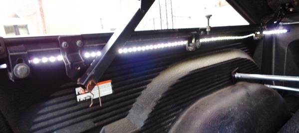

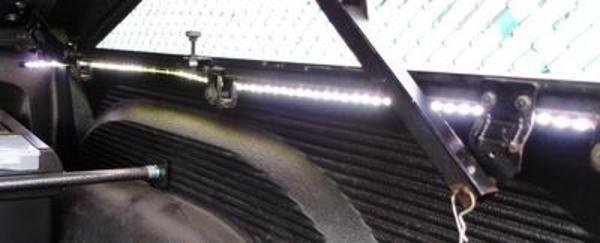

I got these strip lights on Amazon for $28. Tapped into the power wire of my trailer plug behind the bumper.
Self-stick, pre-wired with a switch.
Those look pretty good any pics of them at night with tonneau closed ?

Sorry I don't, but they light up the whole bed like daylight.
My driveway is right under a street light so night pics are tough & not allowed out after dark in my town for now.
