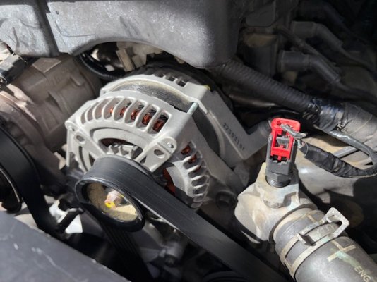

Quick Update, replaced plastic sensor with a new copper sensor from Rock Auto, driving well even though temp reading is a bit lower. Tonight driving home from work check engine light reappears. Will check the code in the morning, but wanted to show dash reading while on the highway, is my temperature reading on the low side? It’s a cool night but this 4.7 would always register higher temperatures.

Rams usually are happier with the OEM sensors. They don't like aftermarket and do odd things with aftermarket installed.
I would say that 69 deg F temp is a tad low, like 120 deg low. If truck has been running long enough to warm up, it should be close to 200 deg F. Either the sensor is NG or you have other issues.

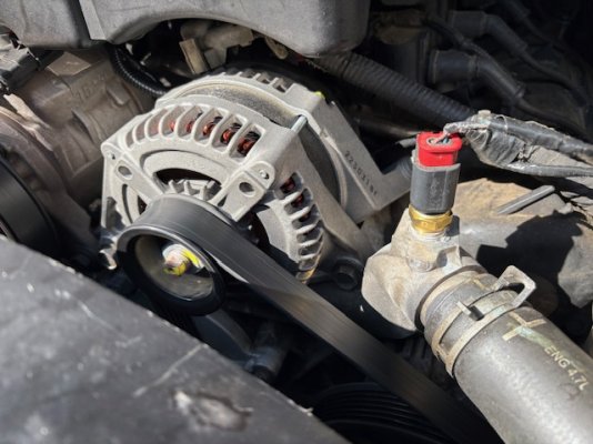

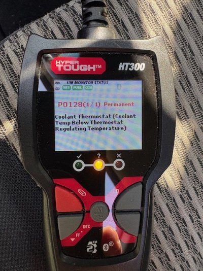

As I suspected code P0128, this time I stopped when the new sensor would not go any further. I will try a new thermostat I also ordered from Rock Auto over this weekend.

Stat may be stuck open. Did the truck over heat recently?
What was ambient temp when you took both those photos?
