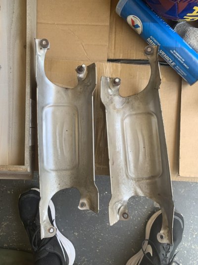

Just doing some prep work with removing fender liners and exhaust manifold heat shielding. As you can see on the heat shields, driver and passenger sides, the rear 2 bolts have sheared (on both sides). At a minimum I have to (weld) extract at least 2 bolts as the shank appears to have broken at the head.
I have additionally heat shielded the passenger side heater hoses. As well as hit all the bolts with PB Blaster again.
The real fun will commence in a couple hours.

Don't be surprised if a 1 or 2 others snap when you try and take the rest out...ask me how I know lol

That top left bolt should come out with some vice grips. If the other one looks like that, I don't think it'll need to be welded.
