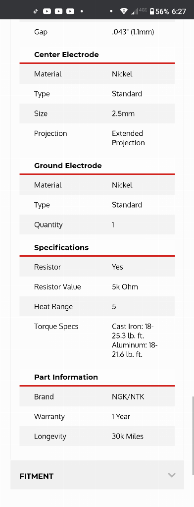

NGK 92174 LZFR5C-11 Nickel Spark Plug
This is the OEM at the time of manufacture. According to NGK, Mopar now recommends an iridium plug in place of this when doing maintenance.

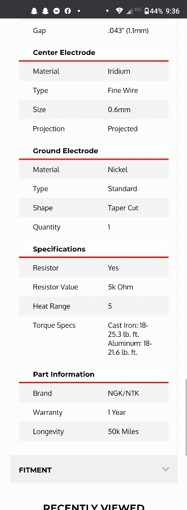

NGK 4469 LFR5AIX-11 Iridium IX Spark Plug

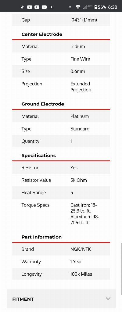

NGK 92145 LZFR5CI-11 Laser Iridium Spark Plug Recommended by FCA for extended service intervals.
This is my personal pick. And what is going to be installed in my truck.

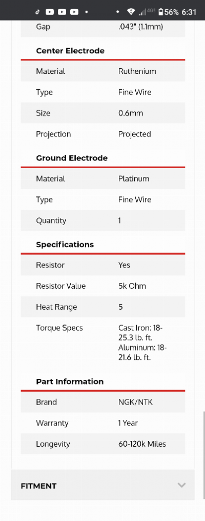

NGK 96355 LFR5AHX Ruthenium HX Plug
I did not go this route due to the extra cost for a plug with a wildly variable life expectancy. I can't justify 3x the price for a 24.9% chance it could last 3x as long. Those are not betting odds for me. Those numbers could always change.
