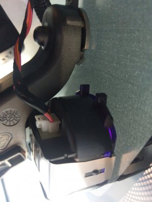

This is a rain sensor correct?

I don’t have auto wipers in my truck but would like to. I can enable through Alfaobd. Thought I might need another sensor but after looking I might already have it. This is a rain sensor right?

That's the humidity sensor for the automatic temperature control.

Can someone post a picture of where the rain sensor is mounted?

Great pic from the link above. I am guessing the rain sensor hides in the lower mirror cover and snaps onto the factory windshield mount?

You are correct for the location of it behind the mirror cover. FYI, you will need a new windshield if you plan on adding this to your ram. The proper windshield has a clear area in the black painted area there for it to work properly
Yup I figured that out. Already have pitting on my windshield just waiting on a big rock to give me an excuse to change it.
The part number for the correct windshield with mounting locations for the rain and humidity sensors is Mopar# 68100277AD
