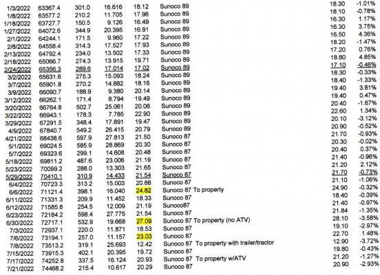

Couldn't resist after seeing a bunch of negative posts on the 3.21. I get why this forum is so lopsided, it's an enthusiast forum so many will be drawn to the 3.92.
But this week I just crushed my best record to date (which was 2 years ago). Back then the best I got was 9.4 l/100 km = 25 mpg. This week, my truck displayed this little goody on the dash:
8.4 = 28 mpg
3 hours 100% freeway driving, avg of 103 km/h, with a light tail wind, MDS disabled, mix of 89 and 91 octane fuel, probably some ethanol in there but cant be certain of the amount.
Reset meter, hopped on the freeway, and snapped pic after 3 hours on the off ramp. So yes, all ideal conditions but it's still far better than anything I've seen with the 3.92. And I probably won't see that again ever, but there is no doubt the MPG savings of the 3.21 are real.
You are not alone.
Column definitions (L to R): Date, miles at fill, gallons used, MPG, comments, EVIC MPG, deviation (mpg v. EVIC mpg)

That is epic, thanks for posting some real data!
So I guess all the comments like "the evic gets more and more out of whack as your mpg increases" were just sour grapes. I suspected as much, but can't argue with the data.
The EVIC thing is lacking diagnostic logic. If you look at the design the PCM receives input from a potentiometer in the fuel pick up. The PCM simply looks at reported mileage and the register fuel level to determine an MPG reading. There is no algorithm. The PCM computes on direct reads. Something would have to be inconsistent in either data in order to realize an internal inaccuracy.
The deviation from 'true' (hand calculated) to the EVIC value is much more logically based on inaccuracies of the fill. A lot of people are not conscious of how many times they squeeze the nozzle. I try to always use the same pump at my neighborhood Sunoco as the nozzle cut-off pressure and the pad level should be consistent day-to-day. However, it's not always practical to do that, hence at other locations I'm getting either short fills or over fills for either of the two mentioned reasons.
