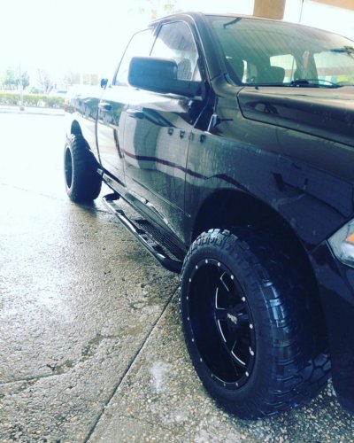

Earlier today I got extremely lucky with a deal on a set of 20x12 -44 motometals w/tires. They were dual slotted 5x5/.5, 78.3mm hub bore. When testing the fit before the purchase the bolts slide perfectly into place. The weird thing is when I put the wheel on the truck to make sure it fit the hub ring was snug but the wheel was really “shaky” without the lugs in place.
For example: my OEM rims I can place on the bolts/hub and they’re pretty sturdy(flat). With these moto metals placed on the bolts/ring it would almost fall off if I didn’t have a hand on it. Idk if it’s because the offset of the rim or the hub itself is really short (not much for the wheel to sit on).
The lugs are ordered so I won’t have them until next Tuesday unless I can find them at a local auto parts store.
I’ve never bought aftermarket rims before so idk if this is normal.

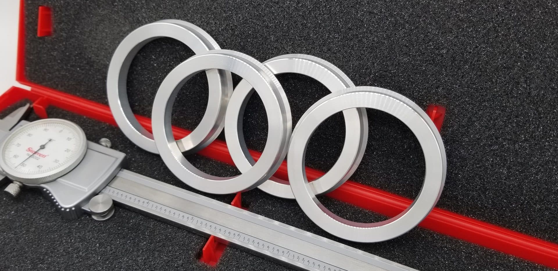

Hubcentric rings is what you will need ... all aftermarket wheels have them because not every truck has the same bore size, so hubcentric rings will give you a correct fit

The size difference is only 1/2 mm. I don’t think they make hub rings that small?

The can mill them to that size .... there are some very thing fawkers out there lol, I am trying to find some but no luck so far ... I am going to reach out to buddy of mine that works for Ultra Wheels in Anaheim California and see if he can get them ....

My wheels had a 110 bore. They are lugcentric but I opted for hub rings to keep it hubcentric as well since stock does both. The closest I could find without ordering custom were 78.3 to 110. Was told by the company that the .5mm would not be enough to even notice. Been that way for 2 years now no issues. Wish they were a bit thicker as they just barely touch the wheel.
