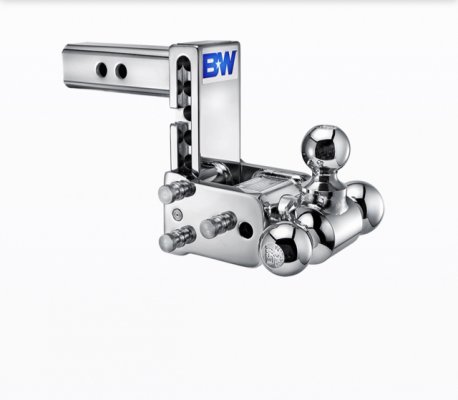

Looks like bw make a tow and stow pintle download.jpeg.jpg B&W-Tow&Stow-Pintle-Stowed-TS10056.jpg

Looks like bw make a tow and stow pintle View attachment 171685 View attachment 171686
Yeah, that’s a nice hitch of all you primarily pulled was pintle-hook trailers but for one, that one doesn’t look like it gives you a whole lot of rise/drop adjustment and, you’re only limited to what looks like a 2-5/16” ball unless you break out the wrenches or just carry a whole ‘nother hitch.

It looks like you could put the multi ball on the same slide. As far as adjustment it looks like you can go reasonably low or straight or flip it and go higher, which is what I mostly run. Its just pins and the piece not being used should fit in a floor bin. Nice thing about a pintle and air suspension is if you set the jack while in or2 you can drop to entry exit and drive away or back in in entry exit and air up to hook in.

On the other hand, that gen y hitch, I could use that with the straight 3-ball hitch I already got.... basically turn what I have into a drop hitch that has a bounce-control torsion system.........hmm. [emoji3166]
But nearly 600 bucks tho, dang. Lol.
