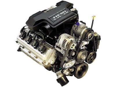

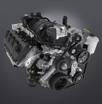

Hence my response. If "that ship has sailed" as you put it, then you're pretty much screwed and that ship is up ****'s creek LMAO, hence my initial response of "Little to no research on this one lol?" No I'll tell you why.
You have a 2007, you bought a 2015 5.7....let's start with pictures, as most of the population seems to respond better to pictures...
Your stock engine:
The 2015 engine you think is gonna work in your truck lol:
Should I go any further or are you interested in the technical aspects?

Joel, sorry for you. But what HemiLonstar is saying is what I also researched and found. My tech shop is closed. CV19. But the owner is a personal friend. I talked with him this morning. He is our local Ram Hemi expert. He said, you are in for a huge expense and frustrating mods to get that 2015 Hemi running properly in your 2007. These are two very different engines. "You might as well have bought a Ford Coyote and try to install" (he can be a a..h...)
What he suggested. Sell the 2015 now. Either determine if you 07 5.7 can be rebuilt or his first choice,,,go on line find one of the exchange companies that offer a 36/36 warranty and order. You will be money ahead and have a quicker usable end product for your money and time. Good luck Joel
