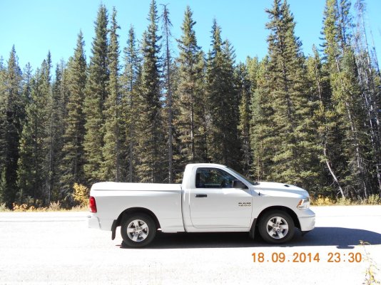

Its a 2014 regular cab Express, short bed, 395 hp, garage kept and it actually fits. Tall, short, light and fast. I see now how quickly I can get sucked down rabbit hole with going too far with "unnecessary preventative maintenance." The only thing I am in disagreement with most folks is MDS. I understand how it works and nothing good can ever come of that idea. Plus, it sounds like crap. Out of control C.A.F.E standards are to blame. Forcing engineers to get blood out of turnips = failure

You should post some pics of the truck,you might say i've got a soft spot for the little RCSB's,lol.
The red one used to give Hellcats fits at the track,lol

Cool trucks huh! The white one and the red looks awesome. I love mine and can tell you do the same. Ill get some good pics of mine on here soon. Mine is (PAR) Maximum Steel in color. Virtually unmolested.
