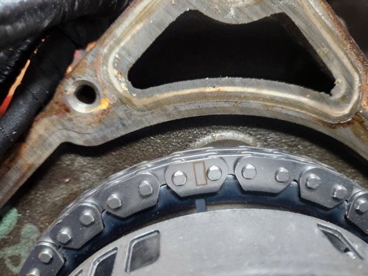

I’m I the middle of replacing the cam and lifters along with new phaser and chain and gear. Cam is installed. I put chain on new phaser with the single mark on chain over the single mark on gear. Then I put the lower gear on chain with the 2 marks on chain surrounding the mark on lower gear. (Pic included) I put the chain and gears onto engine with lower mark at 6 o’clock and upper mark at 12 o’clock.
I then put chain guide on the right side and then went and installed tensioner on left side but I have not pulled pin yet on tensioner. When I do this the phaser moves slightly to the left taking the 12 o’clock cam position more towards 11:30. The links are still on the gear makings as they should be.
is this normal and correct? see pics attached.
I dont see any other possibility since my timing marks on both gear and chain are still in the correct position to each other But I don’t want to move forward until I hear somebody tell me this is normal.

Verify by turning cam to 12 position, if crank goes past 6 then you are off 1 tooth.
Have seen cam at 12 & crank at 5:30 position before with tensioner engaged & being correct.
Degree wheel only sure way to verify.

Degree wheel it. MMX YT rebuild video is pretty clear on the process.

Please ignore this thread as i had the chain on incorrectly. I had it backwards with the single mark at top and double mark on bottom. That is incorrect. My mistake.

That's what I was getting ready to say double marks on each side of cam phaser and single on crank you got it now

from having two ways seen out there you would think it would go both ways but as I am sure some have found the marks are not dead 12 and 6 on chain if chain is laid out straight with crank mark dead at end the two cam marks are off 1 or 2 teeth because of the slack side (tensioner side) has more slack than the leading side so reversing them marks throws timing out that 1-2 teeth CCW
