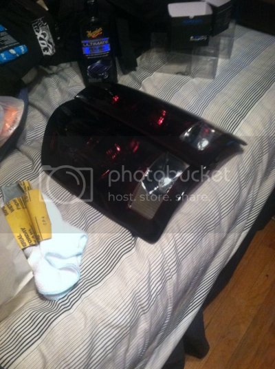

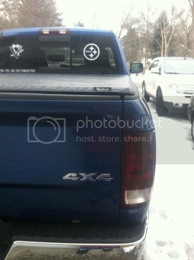

I got my Dad another set of stock tails for Christmas and tinted them for him
Stock tails with tinted third to show the difference
I just barely got done polishing them before I had to head back to school sp i didnt really get any good pictures
Didn't get to finish these either

How many coats? What did u use?

One heavy coat of VHT and a couple heavy coats of of spraymax 2k clear
I've found that light coats can leave a dry appearance sometimes
The third gen tails were a heavy coat and a medium coat
I've finally used up my can of VHT, I got 2 sets of cab lights, a set turn signal lenses from the mirrors of my brothers f150, a set of headlights reflectors an two sets of taillights and two third brake lights (all but my dads tails and third were all pretty dark too)

They look good. I was just thinkin bout recon cab market lights w LEDs. How much light output does this filter after applying use stock bulbs? Do u need LEDs after?
