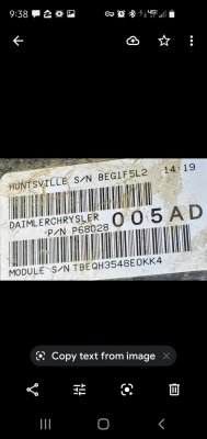

Needing to swap out my TIPM /fuse box. And need to know which #'s are crucial in finding a replacement. I keep finding conflicting information. I have an 09 st w/6.7 4x4 crew cab.

68028005AD from the first picture is the OE part number.
68028002AB from the second pic is the OE part number.
If you can send me your VIN in a PM I can tell you exactly which part number you need to be looking for.
