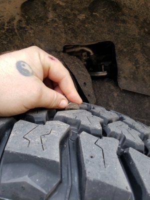

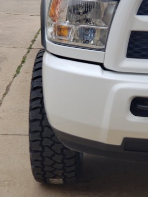

I just put mastercraft cxt on mine 305/70r18
Mastercraft is made by copper they are a AT/MT hybrid tire i only have a couple thousand miles on them so far but good road manners great in heavy pouring rain
Haven't mudded with them but hear they do well there to and $1208 out the door for a 35" ten ply tire i figured i would give them a try
That tread pattern is almost a match for my Mickey' .
