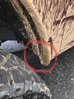

67F53A32-90F0-48F0-92C4-89889DE2F3D5.jpeg 4CD79FA8-649D-4228-AD8A-08BC347F5724.jpeg 947CEC65-E90E-4C80-82FD-4A60C2FE1CF1.jpeg On my 2016 ram 2500 that I did some work to a few moths ago. Installed a level kit ,new wheels,tires (35s on 20s), and shocks. Have noticed when I take a sharp turn and hit a bump I have rubbing on the back of my front fenders. Did some trimming and still did not solve the problem. Without doing extensive plastic trimming and making it look more crappy and exposing more of the rocker panel. Do y’all have any suggestions on what to do. Maybe some cut out fender flares??

I have the same problem only fix is to lift a little more I really wouldn’t suggest to cut more off you have a nice truck in my case I just try not to lock the wheel if I don’t have to
