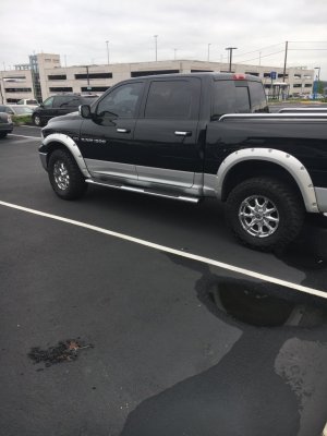

I bought a 2012 Ram 1500 Laramie last year and it came with Nitto Trail Grapplers size 12.5 x 18 x 35. There is a lift but I'm not sure how high it is. When these tires are done I definitely plan to not get mud tires but would like to get an aggressive looking all-terrain tires. How small should/could I go with new tires without making the truck look bad? I really don't think I need 35 inch tires for what I do. Thanks in advance.

Post a pic of the truck so we know about how high it is

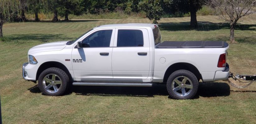

I'm guessing that's just a level kit in the front and maybe spacer in the back. I would think 33s would be fine, and for a metric you could probably even get 275 or 285 70 18. I have 33s with close to the same lift yours appears to be but I have 305/55/20s so a little wider than the sizes I recommended for you, and I'm running 2.5 wheel spacers. If you stay away from the 10 ply tires the weight saving will help your gas mileage, unlike my 71 lbs a piece need a diet tires. 634fd541ca7b9a7a3c3f2759ac4532d6.jpg
