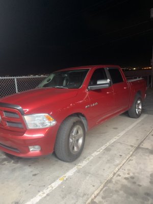

First time Posting been in a dodge truck since 97 at 18YO. Recently, I bought a 2010 ram 1500 w/200,000 on the 5.7 Vvt:Ecc 4X4 with Laramie, tow group package sunroof and the truck boxes (which are sweet) love this truck. Lots here please just advise where you can
Anyway, after chasing codes for 3weeks, Cylinder 3 leaking oil/coolant into it. Local Dodge dealership ran diagnostic says engine toast. Decided to buy Reman Motor from Jasper or Powertrain. Jasper more expensive, and local shops coming in high on my warranty of only $5,000.00. Estimates around 8,000.00. I’m pretty sure I could do it and not fast but can’t really tell if if it’s worth it or how much difference I’d save, and I don’t know anything as tow which re-manufactured between a Jasper and the Powertrain ? Install package and new intake. When I swap what else should I mod or upgrade
