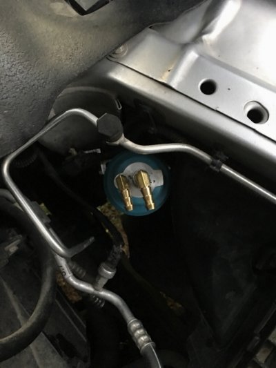

Here’s what I came up with for mounting.
I used some aluminum angle stock to fabricate a mounting bracket, installed two riv-nuts into the vertical part or the core support, and bolted the bracket in place. At the moment, the can is held to the bracket with zip ties, and not plumbed in. I need to go shopping and get some better hose, and try to find some quick release band clamps.
I did hook it up for a short test(that’s when I discovered the hose I had, couldn’t handle the vacuum), and the can seems to function quite well.
Build yourself some hard lines for plumbing it.A couple feet of aluminium 3/8" fuel line hose is fairly cheapthen you only need a couple short rubber lines to plumb it all together

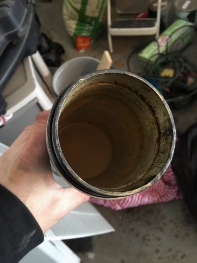

My phone died, so I didn’t get a pic, but I checked the can today.
Only been about 400 miles, but there was a noticeable amount of oil in the can.
So, it appears to be working. I’ll check it again it a few thousand miles, and make sure to get dump pics.

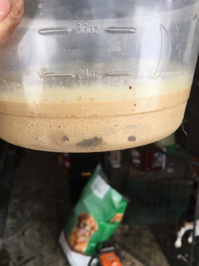

Changed the oil over the weekend, and dumped the can. Had a lot of condensation in the oil. Guess that’s what I get for making a lot of short trips in the cold.
You didn't have to do that, you were good for another year at minimum! Lol.
